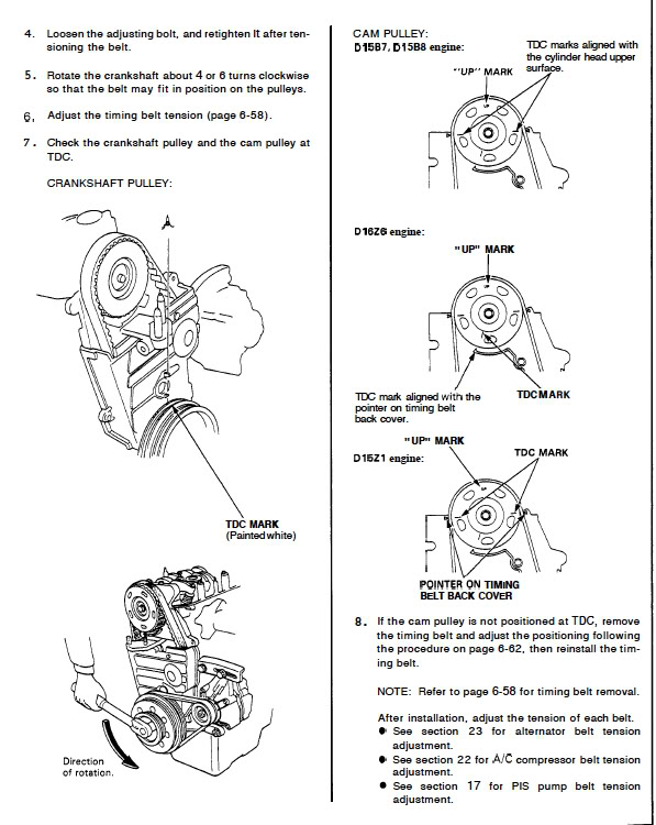

Has the timing belt been replaced? You may want to check the mechanical timing. This is done by removing the valve cover and then the upper timing belt cover. With the front end on stands and the transmission in neutral, you turn the crank pulley only counterclockwise with a socket wrench or breaker bar until the cam gear is positioned perfectly at TDC1 (see below). At this same moment, the crank pulley should also be positioned perfectly at TDC1. If not, the timing belt slipped.
