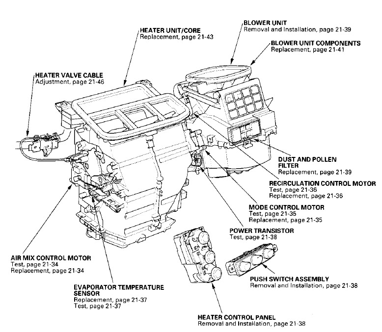

i retrieved the DTC which i noticed in another post. there were 12 blinks = a problem in the blower motor circuit. checked the fuses and they seem fine. i guess my next step is to check the blower motor...where would that be located?? thanks
Old May 21, 2008 | 10:37 AM
Default RE: any thoughts...
Check behind the glove box - the post you mentioned also details the troubleshooting procedure to identify the faulty component.

is this out of a book?? what are the page references to?

if you take out the blower assembly, check for loose insulation that could cause the fan to stop.
ORIGINAL: runswit2guns
See Civic (02-03) service manual:
http://hondatech.info/downloads/Auto/Manuals/Civic/
