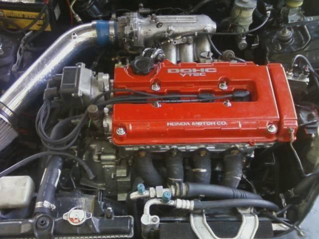

Default V tec motor
B 18 V Tec-honda.jpg motor

Wow, yeah having that hose off there could have caused some problems. You said you reattached it but did you also bleed the coolant system, refilling as necessary? It may have looked normal from a flat surface but there could still be air trapped in the system. Were you experiencing any overheating symptoms?
