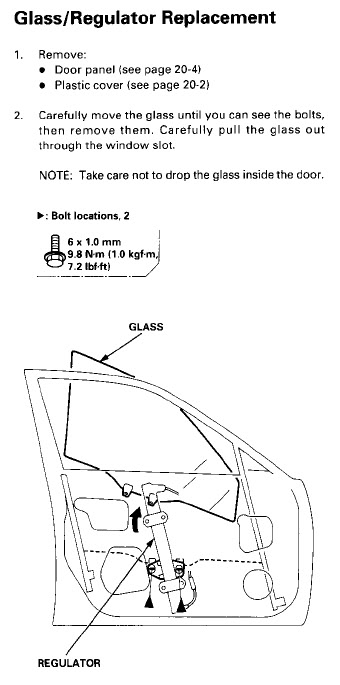

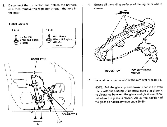

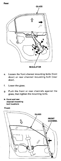

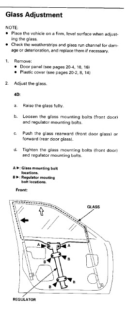

Default RE: before i break my f'n window
