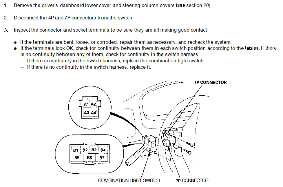

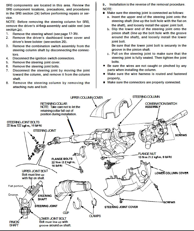

To fix, you may need to replace just the turn signal switch or possibly the entire combination switch assembly:

Well, thanks so far guys. I tried to take the easy route out, but i still need to remove the steering wheel. I did find out that it isn't the turn signal switch. When I removed
the switch, I found the cam that hits the mechanism isn't turning either way to turn the switch off. Does anyone know if that is fixable or do you just need to replace the combination switch? Do you buy just the center part and add your exsisting switches to it?
Old Apr 28, 2009 | 04:21 PM
The central part of the combination switch is bad, or possibly the steering clock spring.
