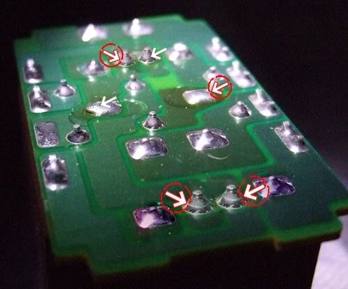

have you pulled your main fuel relay and opened it up and looked at it? the soldering points are known to get hairline cracks, its a real easy fix just resolder them and then hook the relay back up.
you have to look really really good, but if in doubt just resolder anyways
