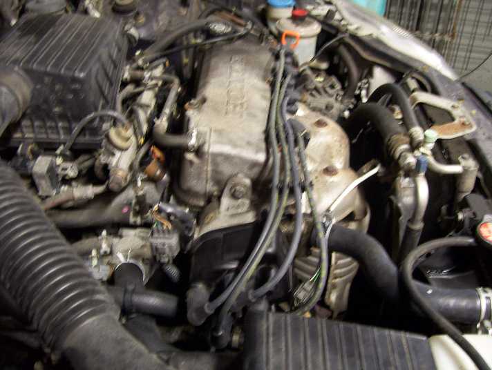

I am attaching pictures of the wiring.

Attached Thumbnails Car won't start after...-100_2669.jpg   Car won't start after...-100_2670.jpg   Car won't start after...-100_2671.jpg

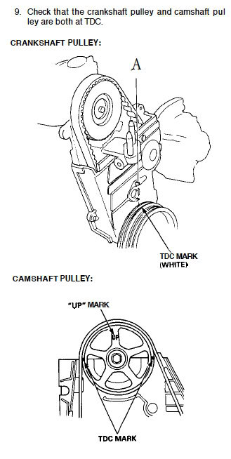

Make sure the distributor electrical connections are secure if you disconnected them. Check the ECU for any codes. People say it is not possible, but with some determination I have been able to put a distributor on 180 degrees out of time. Also, timing belts can skip at any time. So check the mechanical timing, when you have the engine at TDC1 the rotor should point at the wire for #1.

Check the mechanical timing:
