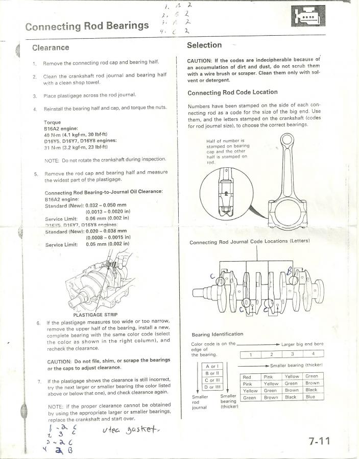

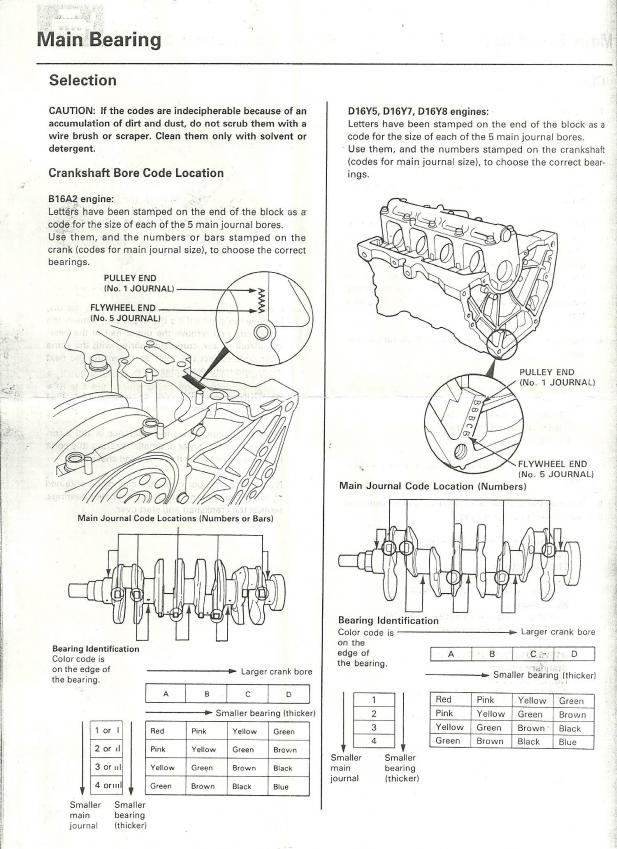

Chart to find out what bearings you need for you motor.
Old May 18, 2010 | 03:50 PM
silver2000civic's Avatar
Joined: Nov 2009
Posts: 242
From: Indiana
Default Chart to find out what bearings you need for you motor.
Mods please move to the DIY. I couldnt post in there. I couldnt post them in photobucket since im at work. Thanks
Attached Thumbnails Chart to find out what bearings you need for you motor.-scan0001.jpg   Chart to find out what bearings you need for you motor.-scan0002.jpg

We can't sticky everything useful, that's what the archives and search feature are for... especially since these pages you posted are directly out of the service manual, which downloadable links to are already stickied.
I'll make this a sticky in the Engine & Internals section if you add more information besides just 96-00 Civics. Try to cover all of the most common D-series and B-series, and maybe even a couple H-series or something.

Not to long after i joined the forum, I asked the question about how to find the color bearing code i needed no one had a clue. I went to the dealer and talked to the parts manger and he got this info out of there honda service manual.
I wish someone would of pointed me to the service manual on here. It was a pain in the a$$ going to the dealer for it.
