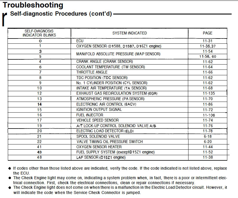

What year Civic?

Whenever you have more than one code, clear them and then see which one reoccurs first. That one probably corresponds to a real problem.
Note that code 14 will occur whenever the idle speed is out of control, which may or may not be due to the EACV itself.
