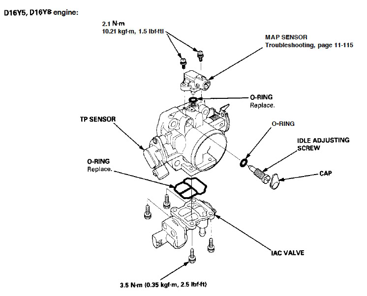

Sorry. I'll try again.
What ECU (computer) is in your car? By the way, it's located behind the front passenger kick panel.
Can this ECU work properly with the IACV on the Y8 head?
How is the IACV wired and does the IACV look like this one attached to the throttle body:
