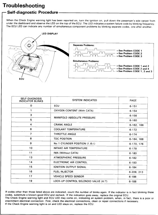

What is the procedure for checking the codes on a 1991 civic? I have never done it on a Honda before and I don't have a manual.
