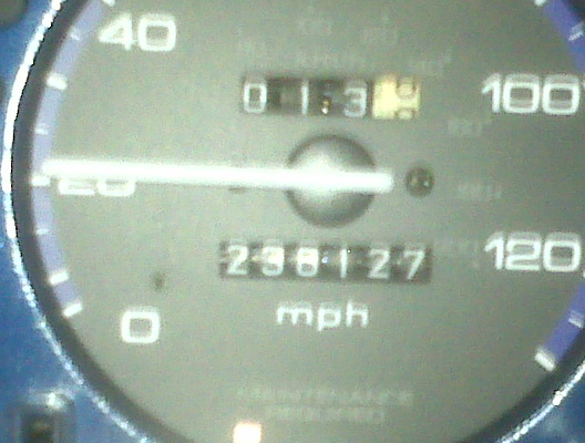

My speedo sticks often and at unusual times, I have a 00 ex coupe. It sticks at 20mph even when I'm going 50, the tach still still works as well as the gas and temp. I haven't had anyone under the hood that would disrupt anything. I hate to say it but if I hit the top of the dash it sometimes works. I have thought it could be the VSS or a wiring problem. Sometimes when it is working and I'm going say 40 it will bounce to 0 and then back to 40. I have no idea whats going on. Any ideas?

Do the tripmeter and odometer continue to work fine when the speedo does not? If so, the VSS is fine and the speedo itself is likely bad.

No the trip and odometer stop working when the speedo stops, but works again when the speedo decides to work. No codes come up either. does the vss have a voltage from it being it is all electronic.

I'm having this exact problem in my 2000 Civic LX that you described. Even down to hitting the dash and it started working (this only worked for me one time - might have been coincidence). When I drive it for about 10 minutes, it will usually start working again - but then erratically stop and start working. If I inch forward in my driveway, the speedometer will jump back and forth between 18-22 mph and as I go faster, it will center over 20 mph. The OD and Trip do not work when the speedometer is crazy. The tach works fine all the time.
