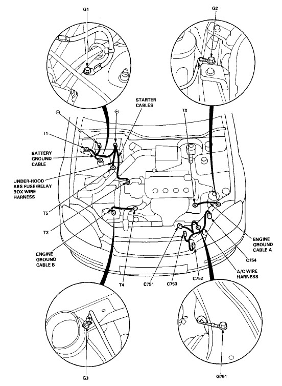

Check G3 and other ground connections:

I went out started following cables and i came across the one in the image Ground wire B (or 8) and cleaned it up got to go get a bolt but it cranked you guys are Amazing i appreciate the help so much saved me alot of money and a tow bill! Much respect Positive vibez ur way!!
