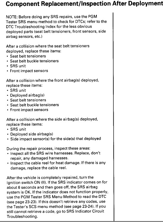

hey guys, i have a 2003 lx civic coupe. about 2 weeks ago i crashed my car. my passenger air bag deployed and my seat belts locked up. my friend told me that i had to buy new seat belts, so i was wondering if these would work
http://www.autopartswarehouse.com/de...QUS-SBELT.html
i was also wondering if i need to buy anything else for my seatbelts to retract again.
thank you
Old May 20, 2008 | 04:51 PM
Default RE: civic seat belts

do u have a pdf copy of the service manual for 2003 civic or know where i can get one? where can i buy the front impact sensors?

so do i absolutley need to replace the srs module and sensors for the seatbelts to retract again?
