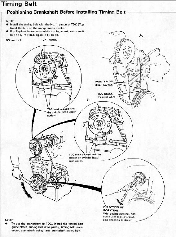

I'm in San Diego. How would I check for jumped tooth or what would be the next troubleshooting step? Thanks kevin
Old Apr 7, 2010 | 09:27 AM
