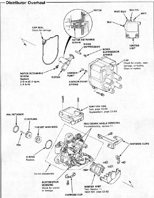

Surgery's over. Recovery's a bitch. Called local Honda man and after explaining sequence of events. He suggested igniter swap before I towed it to him to be fixed. Is it in the distributor?

As I said, original problem was the rotor screw came out and the rotor was loose. What could be related to that failure to cause the car to not start. Turns out I put the screw and rotor back in 180 degrees off from where it should have been. -K

Doesn't the retaining screw insert into only one hole, thereby determining the proper orientation of the rotor?
