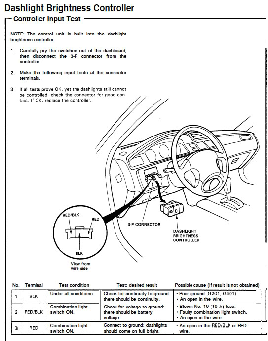

Put a jumper wire across the connector terminals for the red and black wires (see diagram below). With the headlights ON, the dash lights should remain at full bright with no dimming. If so, the controller is bad and replacing it should fix the problem.
