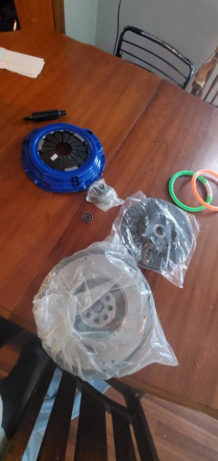

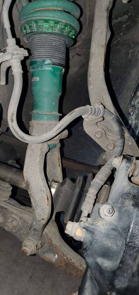

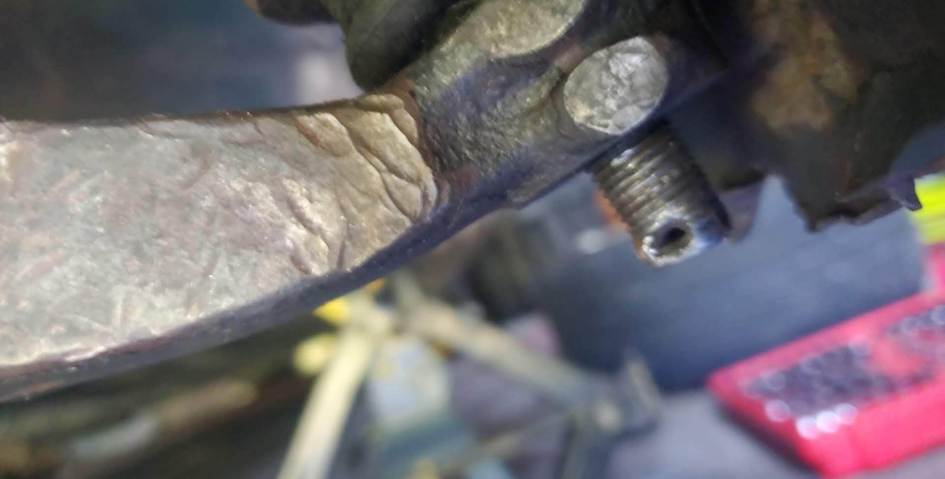

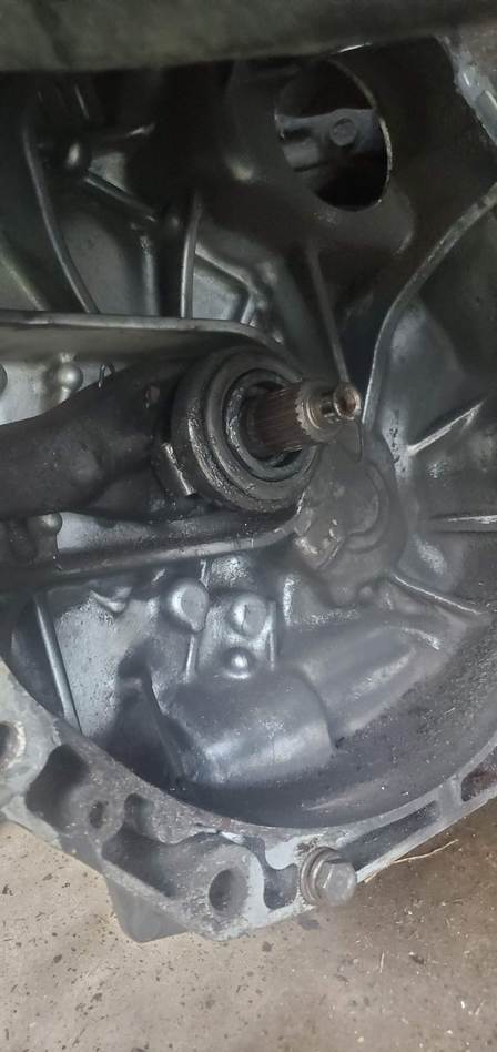

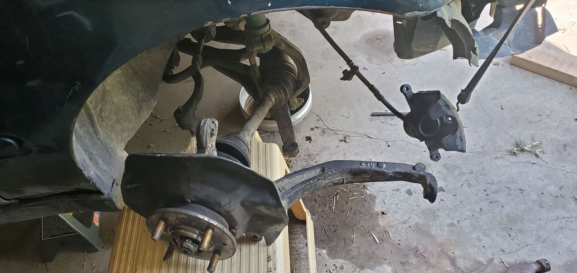

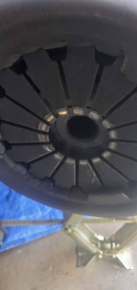

Old Aug 4, 2019 | 07:28 PM
Ivrezul's Avatar
Joined: May 2019
Posts: 5
I hate ball join bearings, this one had to be retreaded
Glad I decided to replace everything
Metal chunks in the axel holes lol
Axle nuts or whatever they are called are the most frustrating part of the entire ordeal
New Parts!
After nearly destroying the nut...it wouldn't come off.
Throw out bearing...nearly ripped apart
See that crack?
Yeah new clutch!
