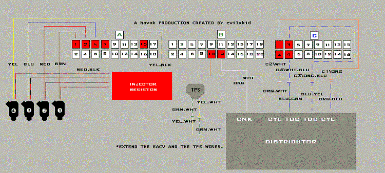

you dont need the throttle cable you can use yours,
here is a nother good diagram you can use.
also you dont pull your harness off, you cut up the si harness and add it to your dx harness.
ive done this swap 3 times if you have any ??? that it dont answer let me know i can help ya.
edit: forgot to mention you will also need the fuel line that connects to the fuel rain. the dpfi and mpfi are different
