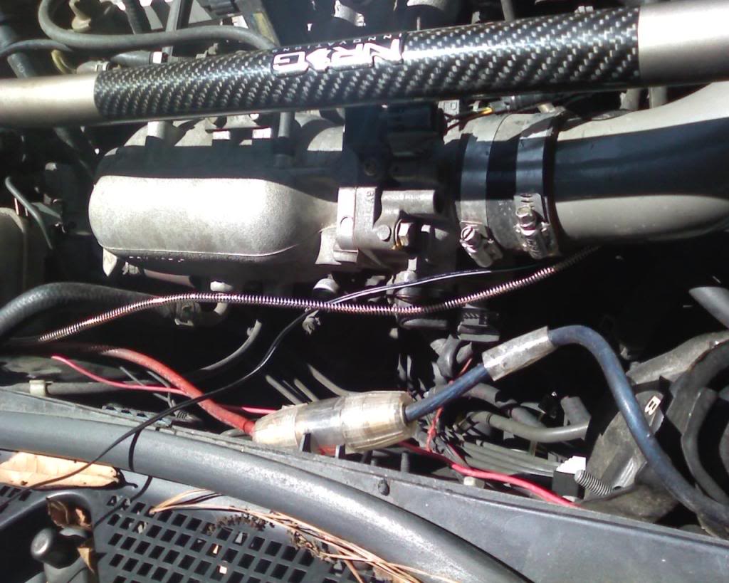

I have a 98 civic ex automatic, When i put it into park it surges up and down from 500 rpm to about 3000 rpm. When i put it into drive it idles still at about 1500 rpm and pulls forward. I wanted to try the iacv before i took it to a shop but i cant find it on my car. It is not on the back of the intake manifold does anyone know where it could be or any other ideas how to fix the problem thanks.....

It's on the bottom of the throttle body on an automatic. The plug comes out the back. I can't quite see it on your picture.
Make sure your throttle cable goes slack and the throttle plate closes completely when not pressing the gas pedal. Check all the vacuum lines and the connection between the throttle body and the manifold, and the manifold and the engine. Anything that lets extra air leak into the intake manifold will cause the idle speed to increase.
