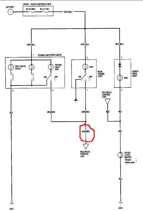

I think the GRN/RED wire between the multiplex control unit and the dome lights may be broken in the region circled in red in the diagram:

nope, doesnt come on with keyless entry, I acts in all purposes as if it's in the "OFF" position
and I'll have to check the green/red wire after work today, because I'm anxious to get this fixed, I loved my dome light
