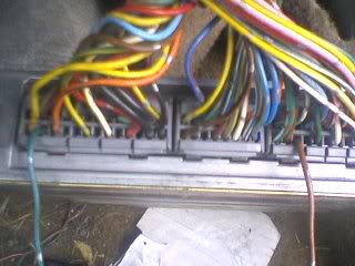

here are the 2 wires you should have ran to the ecu
a4 (vtec solnoid) and d6 (vtec oil pressure sensor)

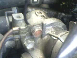

now you should also have the black wire from the oil pressure sensor grounded

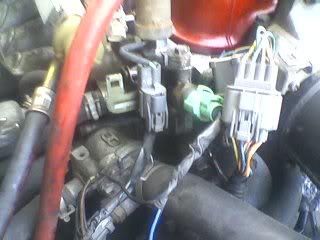

the grey plug is the vtec and the green is the oil pressure sensor
