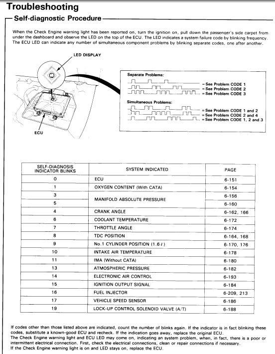

Here's how to determine whether the ECU is throwing any CEL codes:

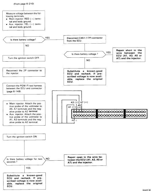

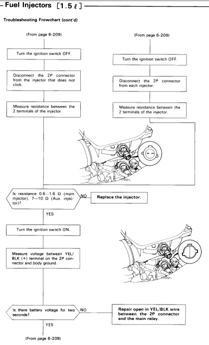

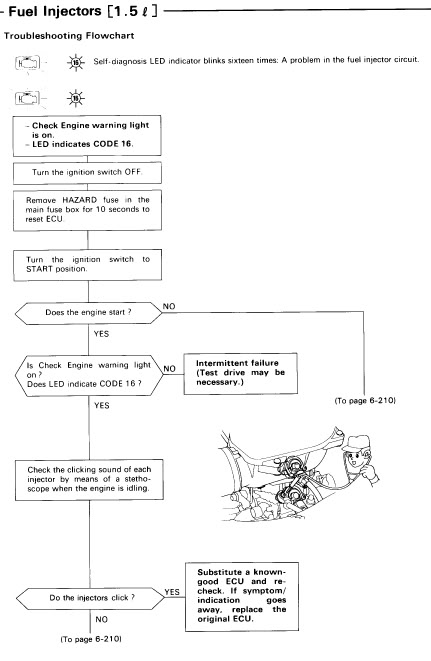

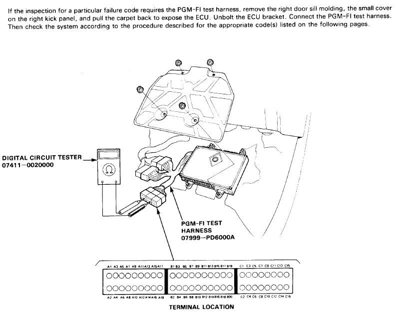

Another possibility is a problem with the ECU activating the dpfi specifically for cylinder 4. Here's how to test:

the engine light has never gone on ...n iv done a leak down test the compression is great performing lik the other cylinders jus when u disconnect the cable it doesnt die down lik the rest do so i figure it isnt poping u no so man im lost should i still do the ecu code check evn tho i dont hav the check engine light on

Yes, it's pretty easy to pull the carpet back and to check whether the ECU is blinking a code. If so, note the code and then clear the ECU by removing the Hazard fuse for a minute and then reinserting it. After running the car, check whether the code returns.

okay so i jus did the ecu check n it blinks once were starting the ignition on n blinks once turning off the ignition
on ur chart it says oxygen content thats nothing big is it so i should hav to restart the ecu

do you think it could be a fuel injector.
i mean i hav changed them before cuz when i first got the car there was water in the tank but i took the gas tank off n flushed it n changed the gas filter n pump n injectors i think thats were the problem came im not sure tho cuz i never really checkd the cylinders till evrything was new how does the injectors in a dpfi work
cuz im thinking maybe its an injector
