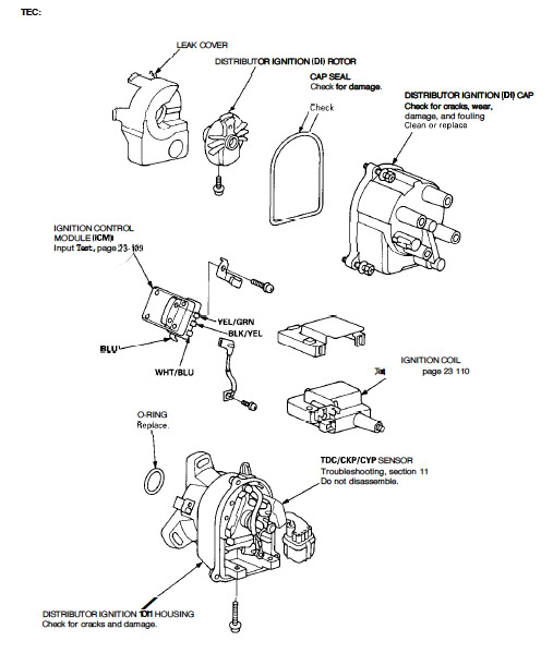

Old Mar 28, 2010 | 06:16 PM
A bad IACV won't cause a bad acceleration. You may have more than one problem.
Any CEL codes?
Have you inspected the contact points in the distributor cap and on the rotor?
Any CEL codes?
No CEL codes.
Thanks for the info.
Could you direct me to a how to on checking the contact points? Thanks.
Old Mar 29, 2010 | 05:28 AM
mk378's Avatar
Posts: 10,023
Especially if this problem started abruptly, consider a skipped timing belt. True misfiring will usually set a CEL code.
