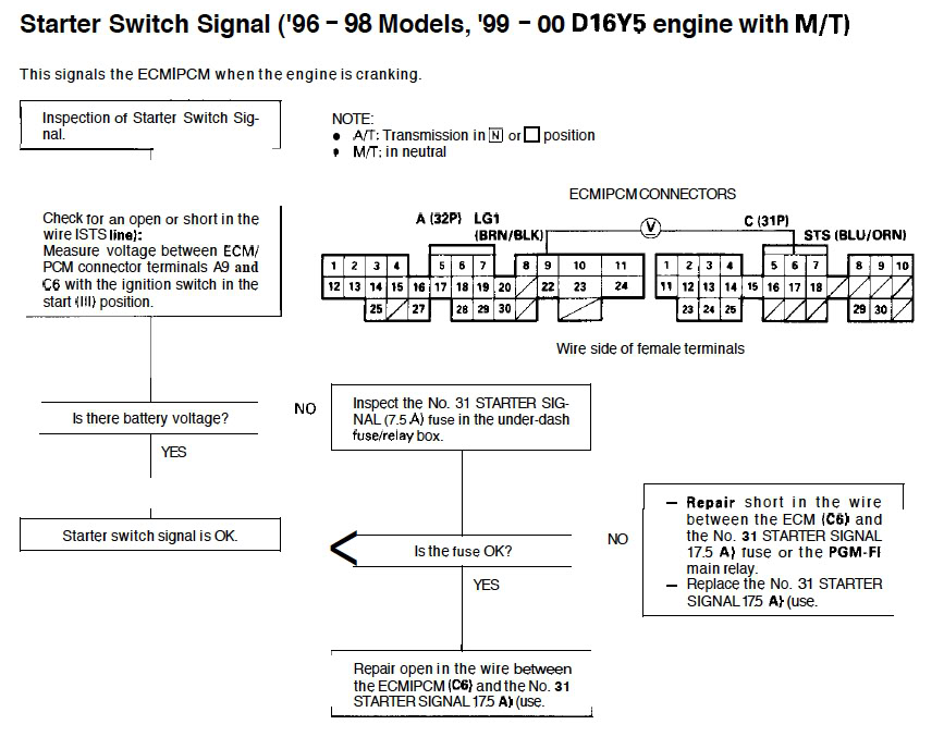

Does the engine idle drop when the clutch is pressed with the transmission in neutral or must the transmission be in gear? Is there any problem with the starter clutch switch at the top of the clutch pedal?
You should probably troubleshoot this circuit:

That's why I posted the diagram. It's for troubleshooting the starter switch circuit that affects idle control. Pull out your multimeter and start testing the wires.
