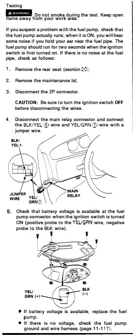

I wasn't sure what you were saying in the sentence above. Does the YEL/GRN wire have battery voltage at the fuel pump when the ignition key is turned to ON?

Have you checked the fuse? Check for voltage at the black/yellow wire on the main relay.
With the relay in place, the power is will not be on constantly with the key on but the engine not running. It comes on for 2 seconds then goes off. While you crank the engine it should stay on.
