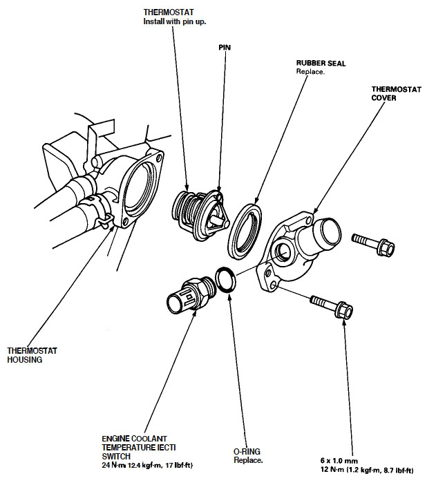

If you are saying that the engine temperature remains below the normal range, then the thermostat is bad or missing.

i have no idea what what image is of but i would have to get it fixxed by someone else, im just wondering what the problome is, i understand the thermomeder might be bad but what would cause it to steam? and get real loud after i buy it?
