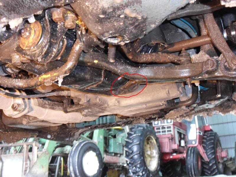

Like I say it's hard to describe. I would say it's closer to the center of the car than any of the others. I might have to take a pic.

If you can't describe it then we will need a picture

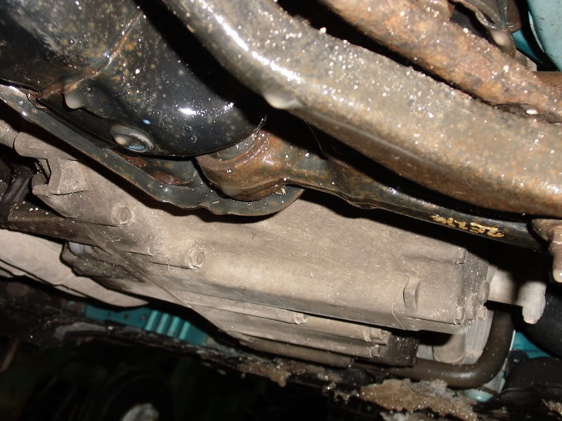

the part has been identified as the lower control arm bushing. It's bad on the passenger side. I have an appointment at 3 today to find out how much it will cost.

You need a bushing press.
Which LCA bushing is it? The one at the bottom of the shock fork, or the one where the LCA attaches to the subframe?

I'm having a shop do it and they say it will be no labor charge if they just have to unbolt and press it out. It's on the bottom of the car towards the middle. I'll get a pic up shortly.

so can this just be replaced by just unbolting it, and pulling it down enough to get the press on it or will other things have to be dissassembled?
