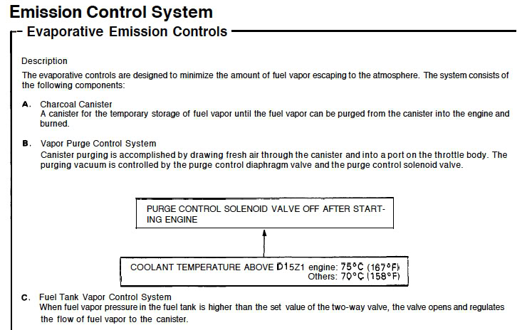

I think the first mechanic has it right in saying that the vapor control return line isn't working. You don't have the problem with the old cap because it does not seal the gas tank and permits gas vapor pressure release. The new cap probably functions properly and seals the gas tank, resulting in abnormally high fuel vapor pressure due to the fact that vapor control line is clogged. This is possibly caused by a faulty two-way valve:
thanks ronj for the diagram. i actually just put the old one back on because that's the only "doable" thing for me last night. actually, when i did that, the fuel went back down and no leaking whatsoever and no smell of vapors. drove the car all day and everything seems alright. weary of the possible changes, when i returned home, i opened the cap and the usual hissing noise came out which is obviously vapor venting from the tank. isn't this an indication enough that the old cap still seals it well or maybe that there are minute leaks in the tank that seems to mask the real problem with the return line?
except for the first mechanic, i asked 3 more and they all blamed the new cap for that. although the designs of the innards of both vary, the old one was simple with a plastic cap with 4 little holes in it, the new one was more elaborate and more hollow on the inside. i don't know now if this is the possible issue? one of them had the same problem, although in a motorbike, he said he replaced a cap because his was venting fumes, when he put a new aftermarket cap on, same thing, fuel gushed out unprovoked.
