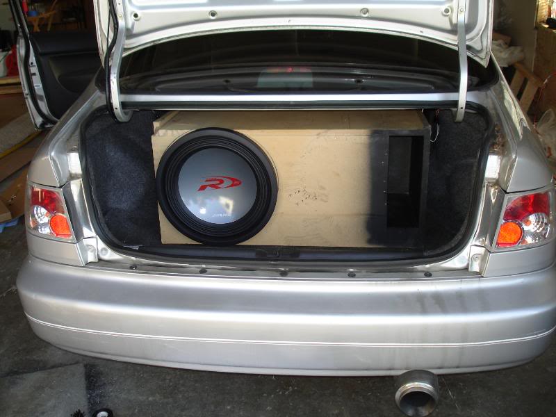

LMFAO no wrong bass... this is my addiction 2 bass

WOW!!!!
Sorry about that!!! I use to do a lot of music also, I still have some pretty good eq. (old but decent).
