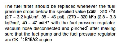

Originally Posted by TheJGB3
According to my Honda service manual it says only to replace the fuel filter when your fuel pressure at the fuel rail drops below a certain number (which I don't recall or I would mention).
^+1 (see text from service manual below).
The fuel pressure is measured by attaching a fuel pressure gauge to the fuel filter.
