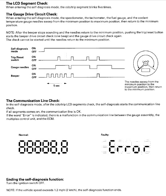

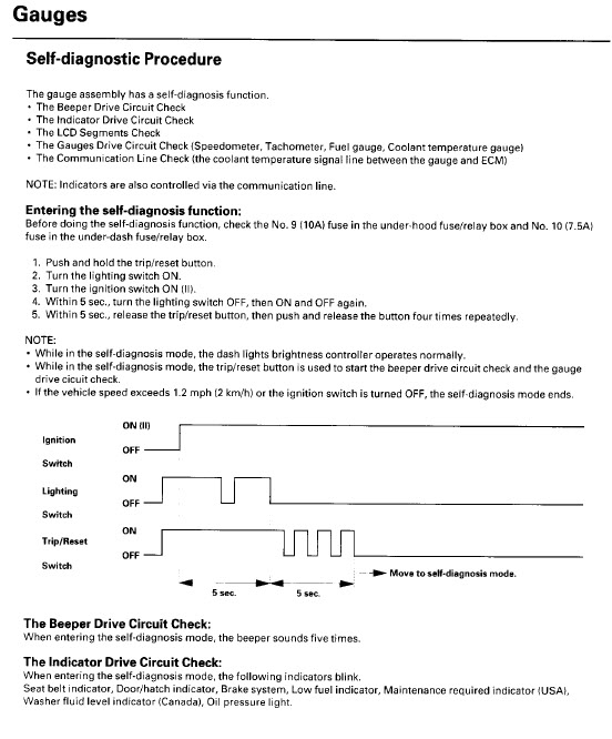

The connectors at the rear of gauge assembly, the ground wire (G501), or fuses 9 or 10 may be loose.
Also try these tests:
