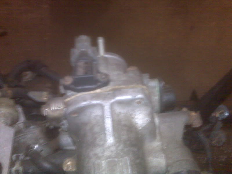

ok. so i took a look at the motor and noticed that the motor has the wiring harness still on it. so can i use that with the vtec ecu. or no? and these are some things that i noticed with the motor. and i was not kidding with the cardboard in the IM.Name:  motor2.jpg
lol.

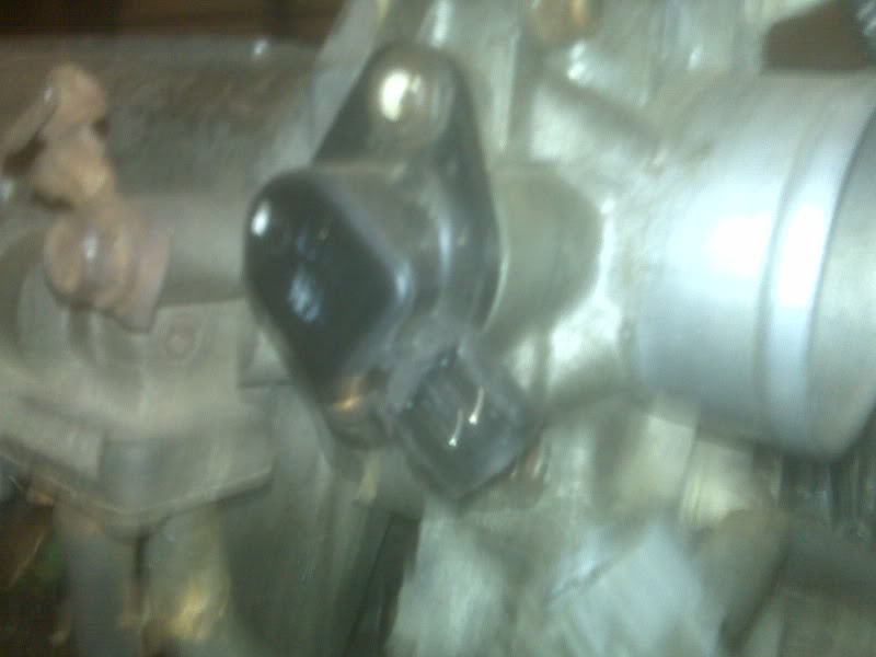

and then i found that this clip was broken.

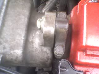

i took a pic of what i thought was the vtec solenoid but did not match the location of the where it is in the pic above.
