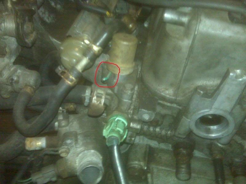

ok so i found the vtec solenoid. the only thing i have a question on is what is the little green wire that is hanginh off of it. it seems like it was cut but dont know where it goes.

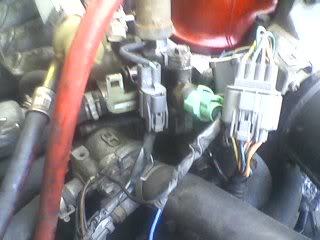

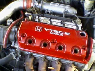

thats the tps (throttle position sensor) you can take your im, or tb off your motor and it will fit on theat one.
heres pics of a vtec soleniod

this is what the vtec solenoid looks like...what is that wire hanging out of it? is that what i connect to the ecu?

yes thats what you connect to the ecu and also just below that you see the green plug.
the black wire is a ground. and the blue wire goes to the ecu.
when you use a non vtec dizzy on a vtec head only the top bolt hole matches up on the head the other 2 dont. it will run fine until you can get a vtec dizzy then all 3 bolt holes wil match up.
