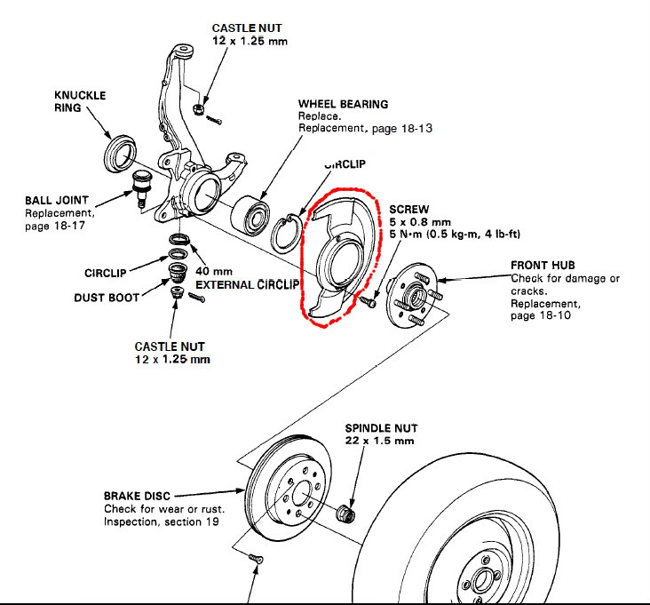

If the car is not too far away, drive it home, put the front end on stands, pull off the wheels, and inspect the brakes. Also check whether the shield indicated in the diagram is bent and rubbing on the wheel.
