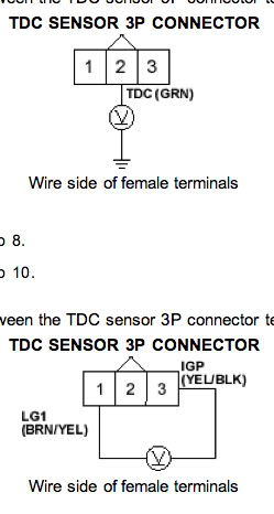

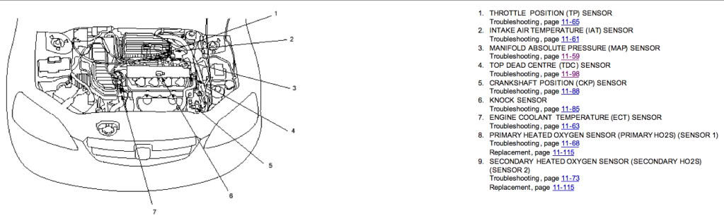

I made a mistake in my first post. P1361 indicates a problem with the TDC sensor (see first diagram for general location of sensor), which should be accessible without removal of any engine components. It also can be recognized by its 3P connector, which has three wires (see second diagram). Then go to pages 11-98 to 11-99 in the 01-05 manual for details on troubleshooting the circuit problem.
