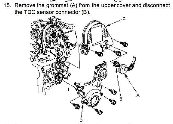

Can you post a photo of the wires? Do the wire colors match those of the TDC sensor (see diagram)?

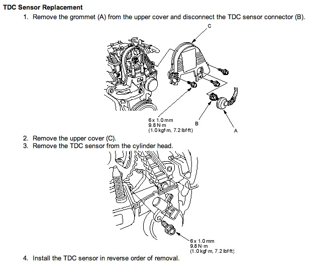

You can access the TDC sensor connector through a grommet in the upper timing belt cover.

Thank you so much for your help, I ended up doing the job in like 45 mins.
so easy.
