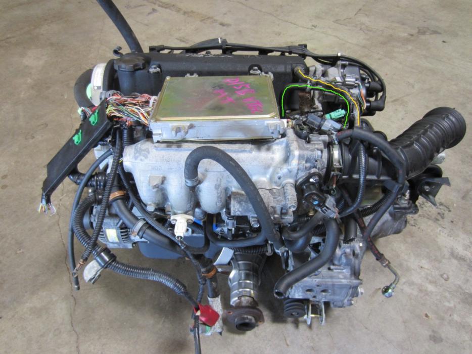

Does any one here know what this hose is call and where it plugs into?

That is a bypass water hose connect to a valve under the throttle, then the other end is another hose that connect to your IACV
