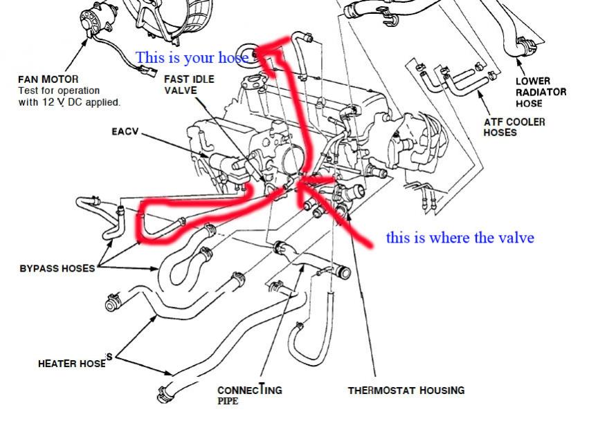

my bad.. see the attached pix

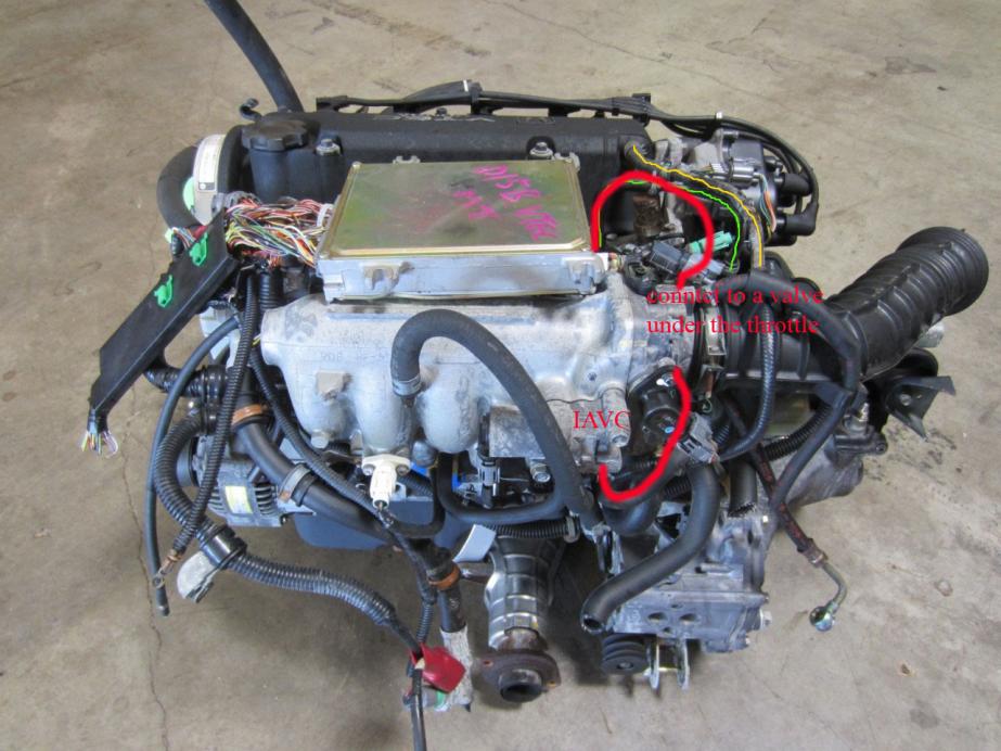

Ok.. here is another pix
