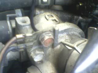

here is pics of when i did it.
my 2 wires i added to the ecu,
the black wire coming off the vtec oil pressure sensor gets grounded
only need pin a4 and pin d6 for sohc vtec hook up

Thank you.... Just to be clear tho... I ground the black wire coming off the oil pressure switch (the green plug right?)... and then I take the other wire off the green plug and tap it into d6... with an ecm pin (where do I get ecm pins) Then the wire in the grey plug gets tapped and goes with an ecm pin to a4.... Is that all correct?
Old Mar 25, 2010 | 06:07 PM
you can goto a junk yard and yank them out of other civics or send me 2$ via paypal and ill mail you some,
the grey single wire plug goes (vtec solnoid) goes to a4 and the oil pressure wire goes to d6 and the black wire gets grounded.
