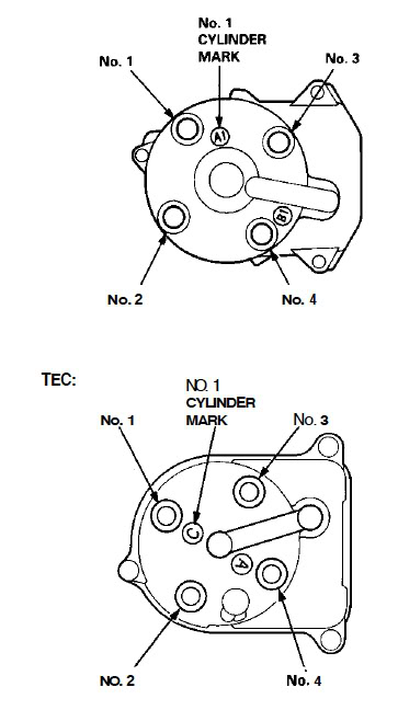

Is the CEL ON?
Did you happen to reinstall a couple of the spark plug wires in the wrong firing order?
The cylinders are ordered 4-3-2-1 from the distributor to the timing belt:
