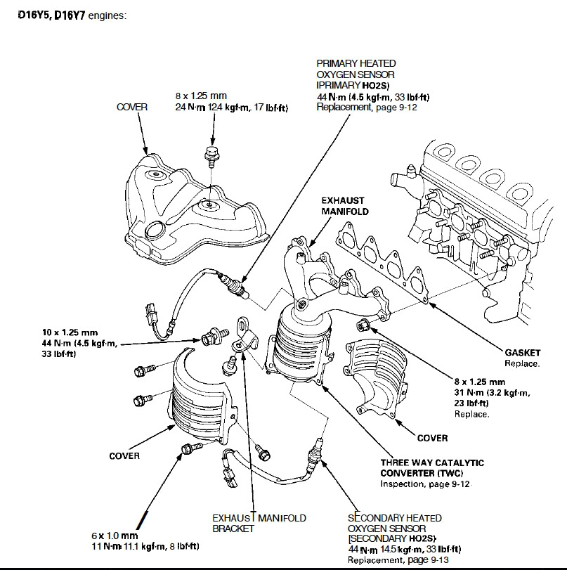

I missed this in your last post. For the test I suggested, you need to unplug the upper (primary) not lower (secondary) O2 sensor (see diagram below). If unplugging primary O2 sensor doesn't help, then test the ICM.

The ICM is located inside the distributor right? My distributor is brand new, and I actually tried both O2 sensors, unplugged one, plugged it back in, and then unplugged the other while driving the car inbetween.
