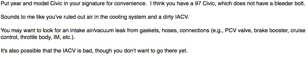

Default RE: huh??

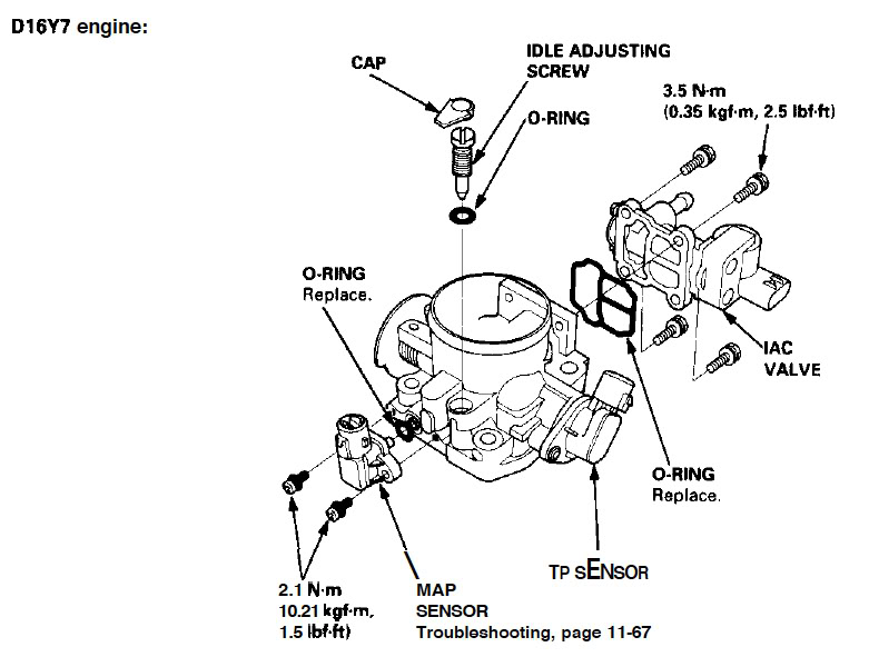

Default RE: huh??
Does covering the IACV port in the throttle body with your finger stop the idle speed fluctuation? If not, the IACV is not the culprit.
Are you saying that you think that the TB gasket is leaking?
One way used to test for intake air/vacuum leaks is to spray carburetor cleaner around suspect leak areas while the engine is idling. Any change in idle speed suggests the location of a leak.
By the way, have you yet verified that the idle screw is adjusted as specified in the service manual?
