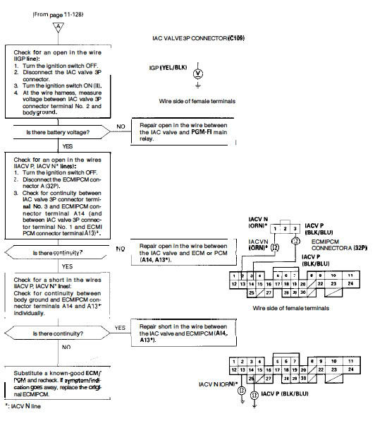

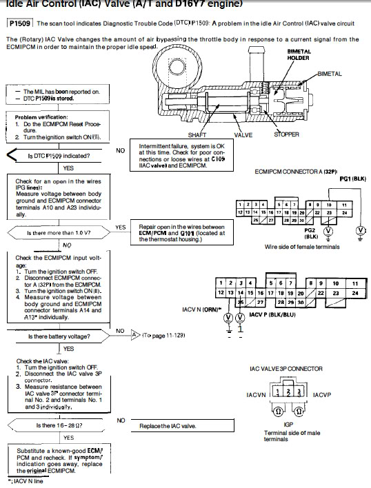

any way to check the resistance of it? what are the specs?
