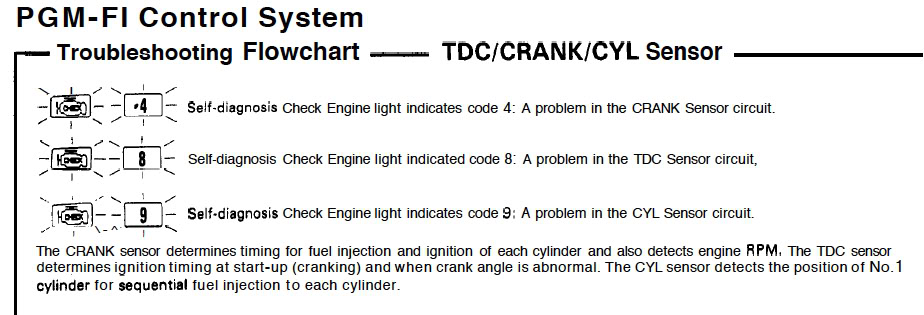

ok so ya i did this and it said it was a #4 crank position sensor.. wtf is that?? and how does that have to do with anything thats causing it to spapper at 3500 plus rpms?? any guess?
Old May 11, 2009 | 01:39 PM
The car will run like crap or not at all when the crank sensor is bad. Replacing the distributor housing should fix the problem.

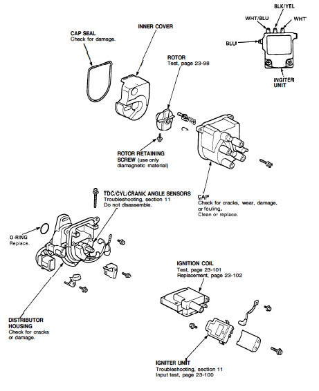

ok yea that didnt work ,changed the int module,coil,disturber,rotor,plugs,wires,oil,still samething with same code.
Were is the CRANK POSITION SENSOR AT and would my local auto parts store have this?? cuz i went to advance and its not something they can even order.please help i'm about broke from all this
No, you need to replace the distributor housing, which contains all three distributor sensors.

cant i get a crank position sensor off a junked disturber??? cuz a whole new disturber is 200$ plus dollars ,,and i just put that in all these parts already, how can i drive it like it is u think?
Old May 12, 2009 | 05:47 PM
Yes, or just pick up a whole distributor.
