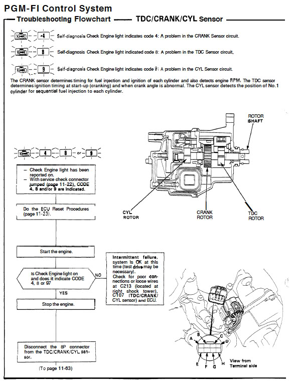

Heres exactly what it does ......When i first start it up from it setting for awhile the engine light doesnt come on and it doesnt sapper and goes pass 3500 rpms .. then after driven for while , when i slow down the motor will just shut down , i start it back up and it shut off a second time, after the third start up the engine light comes on and it stays running but sapper if i try to go passed 3500 rpms.
I do the self code test again and it blinks 4 times quickly and then theres a pause and then blinks 4 times again. but i've replaced the disturber .....i did notice the fuel filter was kinda rusty and i was going to replace that and see if thats it .....any ideas ??

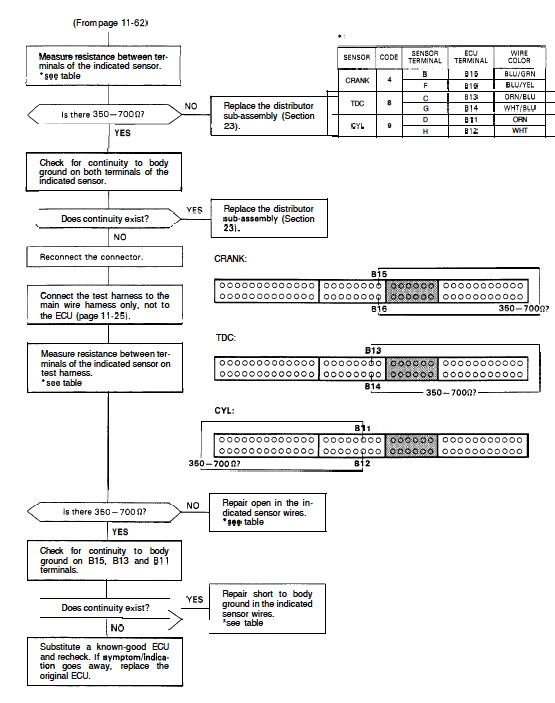

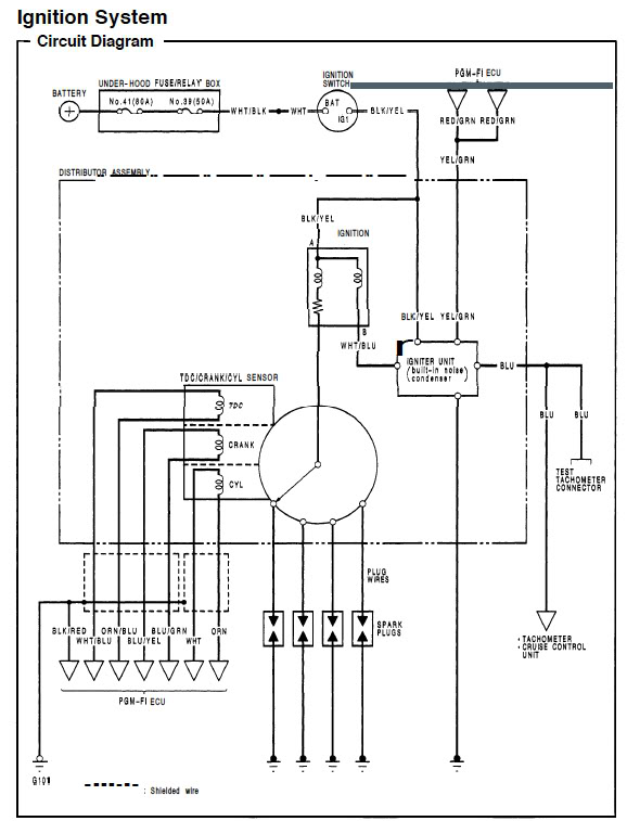

You now need to test whether the two wires running between the Crank Sensor and ECU are broken or have a short (see diagrams). If the two wires are fine, then your ECU may be bad.

Ron, I took the whole disturber off and check out all the wiring i did find a crack in my connection so i tape it up really tight , i also notice that the guy that had the card before had labeled the wires that connected to the coil post and negt , were wrong according to the directions i was reading and so far its working lol this whole time!!!
So trial and error and i've learned alot bout my car now so thanks for all your help man ,if anything else pops i'll be in touch hehe!
