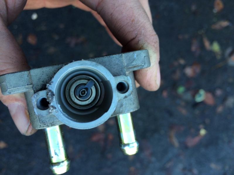

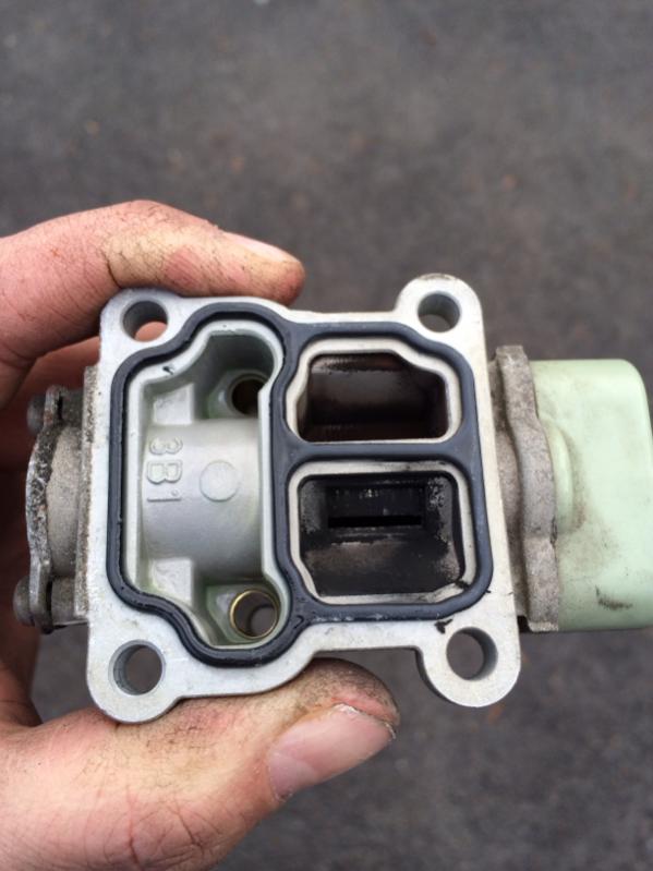

Hi All,
Today I had a go on the IACV and I did it without taking the TB apart.
As I don't have any TB gasket, therefore, when removing the TB, the gasket might get ripped. Also as I don't have any gasket sealant, (I will order a TB gasket and some gasket sealant just to have it for the next time), I have decided to have a go without removing the TB.
It took me 3 hours with patience and a bit of swearing to complete the job. The worse part was to disconnect the coolant hoses which were sticked to the IACV and then remove the hose clips which for my luck were facing back. With no room to play with tools or for this type of clips with the plier, there was a bit of play and swearing. Then I realised that it was better to rotate the hose clip from the back to the front so I could have a better grip with the plier and take the first hose from the left to right and then do the same with the second hose.
It was much quicker to put everything back than taking it apart.
I used a small brush to clean inside the IACV, but be aware of not leaving any hair of the brush inside. As I have an air compressor, I just sprayed everything and put everything straight back in place without waiting half an hour like some people say to get everything dry.
Be aware of putting a rug or cloth under the IACV when taking the screws out because you may loose some screws or even loose the IACV gasket. If you loose a screw, it may end up in some awkward place to pick it from. I have a telescopic magnetic picker but there are some places where a magnetic picker can't get in to unless it is a flexible one.
Now I just can't wait to do this job in my wife's civic, lol.
