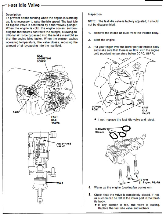

Clean the IACV (see link in my signature), check for intake air/vacuum leaks, bleed the cooling system of possible trapped air, and check the Fast Idle Valve (Correction -- I don't think the 91 Civic dpfi has a fast idle valve):
Old Jan 10, 2009 | 08:26 PM
Fast Idle Valve may be busted. This happened to me, but caused much more severe idle surging... yours may be not as busted as mine was though.
Unbolt the FITV from the throttle body. If coolant comes out of the FITV from any of the air ports, it is busted.

Actually, it's the two-wire sensor located below the distributor. The coolant temperature switch that controls the radiator fan is located in the thermostat housing.
