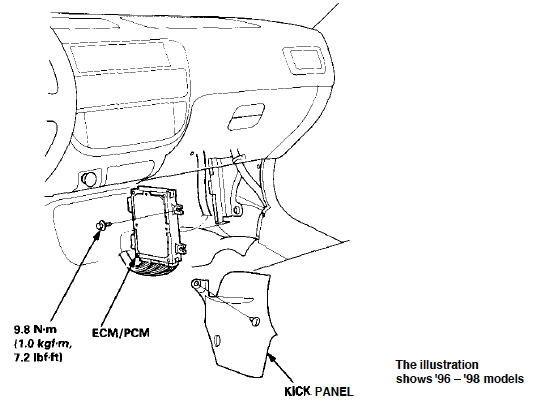

Is the ECU wet behind the passenger's front kick panel?

hmm I have not checked the ECU yet.

checked the ECU...its dry.
