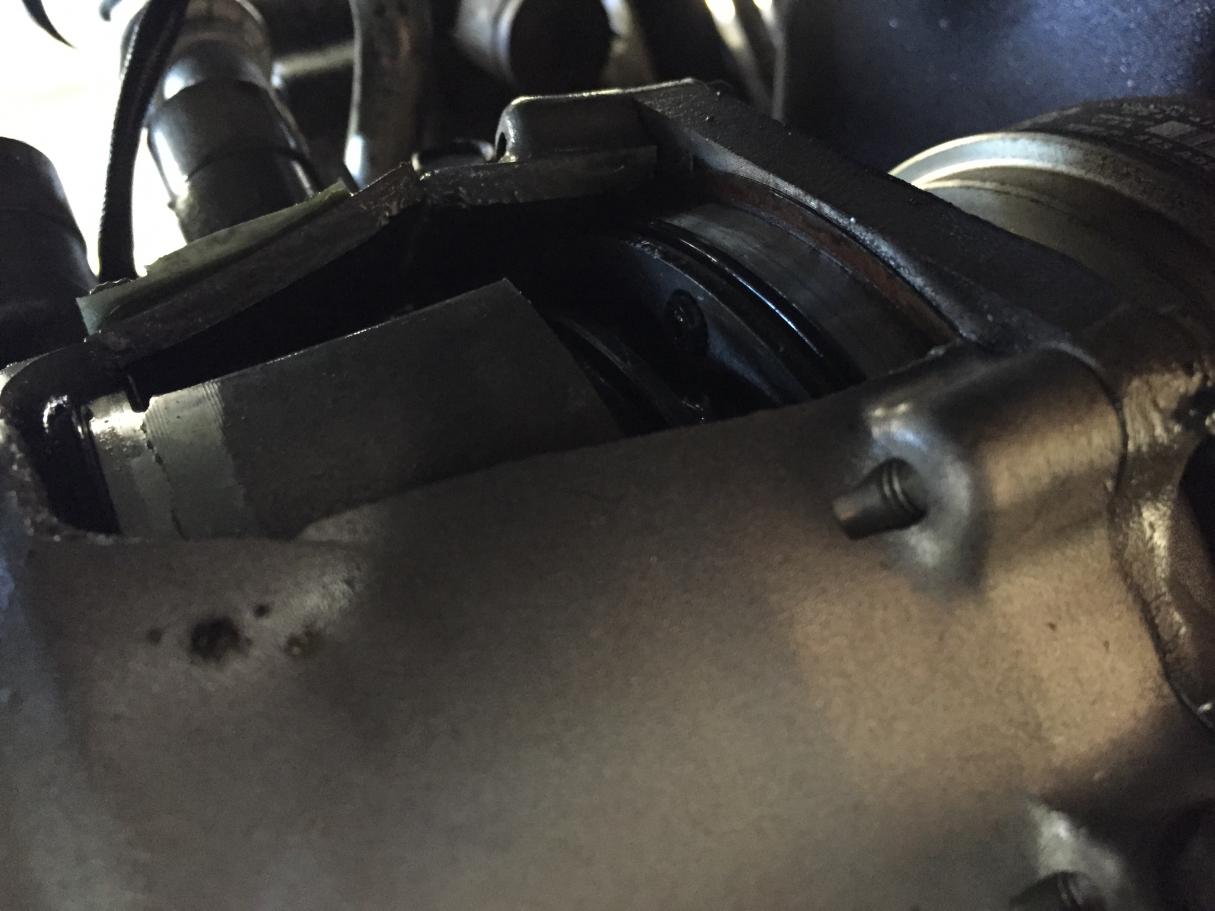

Had this puppy disentigrate rolling about 70mph on high yesterday in 100 degree heat.
Usually... I do all my own work, except in my older age... I'm guessing taking it to an ASE certified, full warrantied partner for $600 is the smartest bet.
And... A few days shy of my birthday! Oh well. Happy to be here, look forward to chatting with you all in the future when it's my time to wrench!

Yes they do that. Warranty is a great thing because before it does that, it will typically send out shards of metal that will cause repeat failure if not fully cleaned out of the system. Condenser is usually replaced being the first component downstream of the compressor and difficult to clean out.

Full flush... Replacing everything but the lines. Here now. Great shop in Mesa AZ if anybody ever needs it, shoot me a PM.
